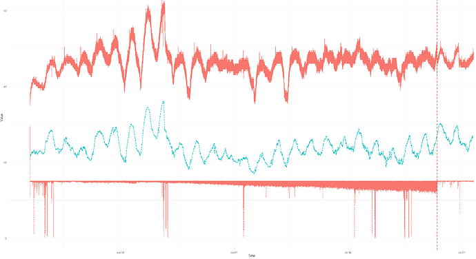

with several Femto Mega cameras, the fps rate deteriorates over time.
If a restart is made via power off and on or software reset, the system recovers and starts with a stable frame rate, but then deteriorates over time again.
I use firmware version 1.3.0. SDK v2.3.5.
We like to get 15 fps from the 3D stream with 320x288,Y16,15fps and RGB stream 1280x720 at 15fps.
The 3D stream is decreasing over time.

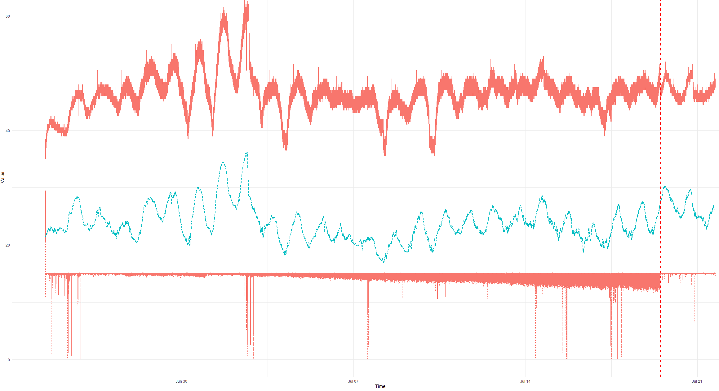

In the following picture you can see the cpu temperature of the Orbbec in °c in red in the upper area, an external temperature sensor also in °c in blue below and then the FPS rate in red.
A vertical red line marks the time of a reset by switching the power off and on. The x axis is time.
Any idea how to fix this without regular resets?
