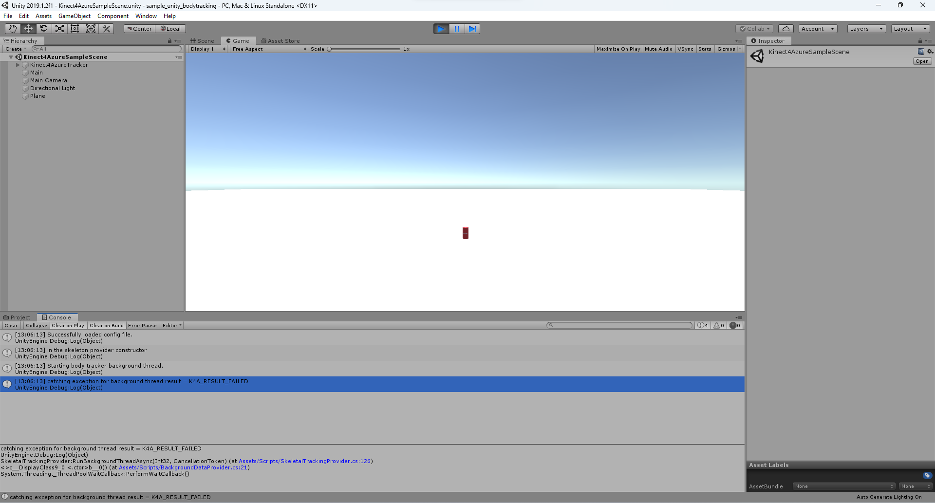

I’ve updated the Femto Mega firmware to 1.2.8 and run Unity and Visual Studio in Windows 11 Pro. I’ve followed the instructions, but after many tries it’s still not working and ends with a K4A_RESULT_FAILED error. I’m not sure how to copy/paste a screenshot here, so here’s a link: https://www.cnx-software.com/wp-content/uploads/2024/01/Unity-Error-Femto-Mega.png
The skeleton tracker use gpu processing mode by default, you can change to cpu mode and try to run, if it works (but slow performance), than you need to follow the fourth step in readme doc to make other mode work.

Please make sure your project folder contains the Lib subfolder. If it does not exist, you may not download it from Orbbec’s github.
Yes, it looks like it was the issue. Rendering must be set to CPU (GPU not working right now) and the Libs folder was not there.
