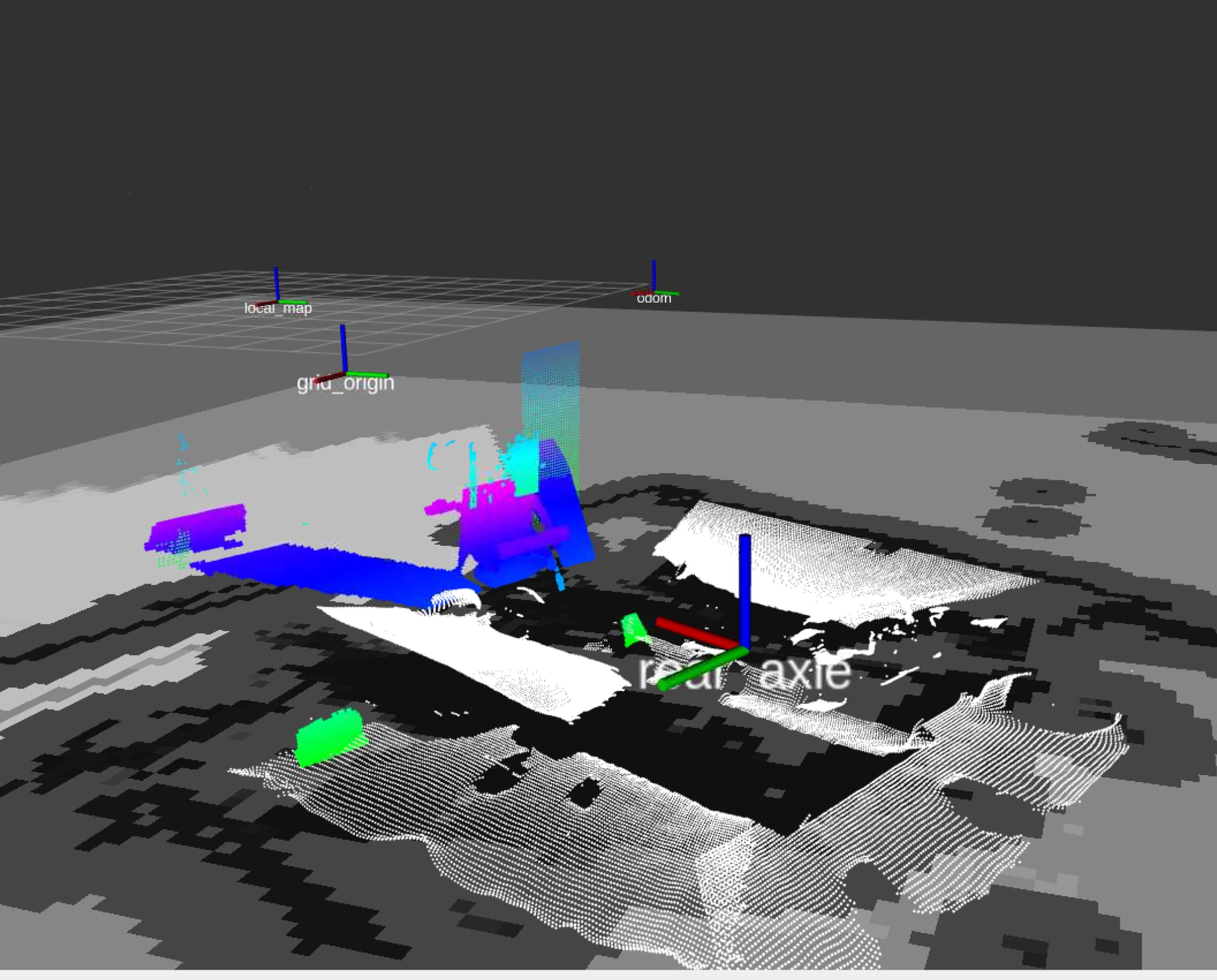

Problem:
Over time, the point cloud becomes invalid (phantom points start to appear in empty areas). It starts getting worse after ~30 min of the ROS2 wrappers running.
Here is the corrupted point cloud screenshot:
Any help would be appreciated.
