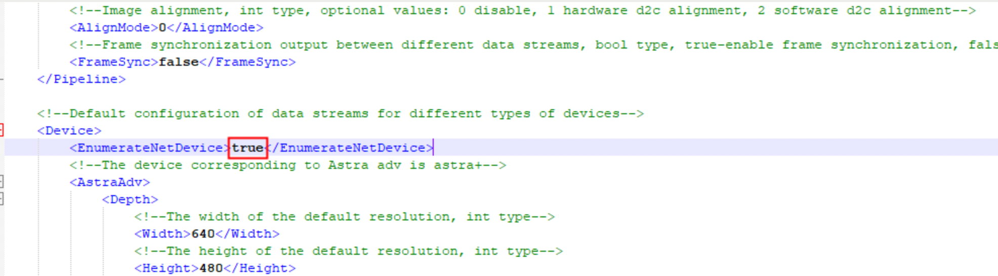

I found the description ‘Modify the OrbbecSDKConfig_v1.0.xml to change the value of EnumerateNetDevice from false to true’ on the page titled ‘K4A Access Femto Mega Network Mode’.
By setting this, I was able to confirm that the Azure Kinect SDK can be used with a POE connection.
