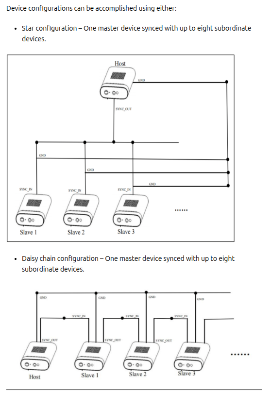

We’re using multiple Femto Mega cameras for a project and I was confused as to whether or not you need the Sync Hub if you can daisy-chain the cameras sync cables together as shown in this diagram found on the Femto Mega documentation:
We avoided ordering one initially under the assumption that this was the case, but evidently, we discovered that the secondary camera(s) don’t seem to recognize the primary on start-up after following the recommended setup directions. The hexagonal sync hub on the products page is listed as two separate products – “Sync Hub Dev Star” and “Sync Hub Dev Daisy Chain” – even though they seem to operate exactly the same. Does anyone have some insight into what the daisy chain setup is suggesting accomplishing and what difference there is between the two products? Thanks.

You have to have a sync hub for multi camera sync solution.
Refer the docs:
