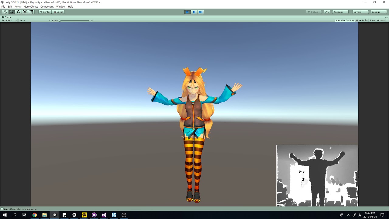

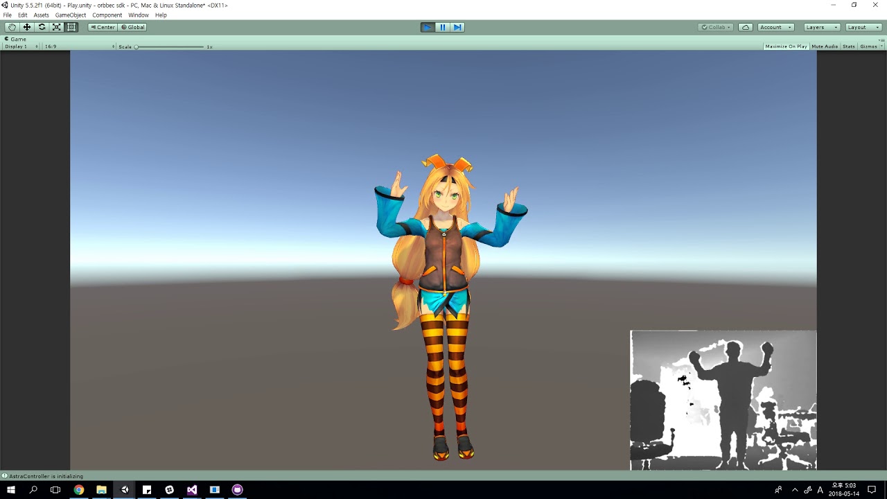

I make avateering script with orbbec unity SDK but it has problem.
In my video, it works pretty good but when I raise the knee, its joint doesn’t get rotation value.

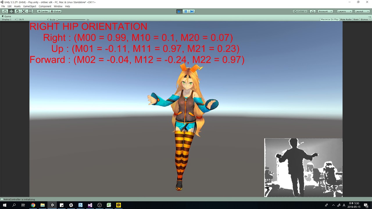

+Additional findings
It seems like a problem of Orbbec SDK.
When some condition is met (I didn’t figure out the condition yet), the joint orientation value stops updating and is fixed to a certain value.
Mostly, it happens in legs and waist.
Thanks in advance.
