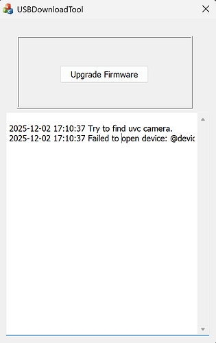

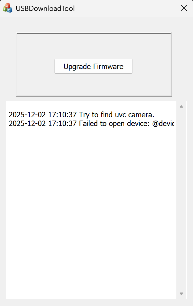

I have the same issue, but the trick with using USBDownloadTool does not work.

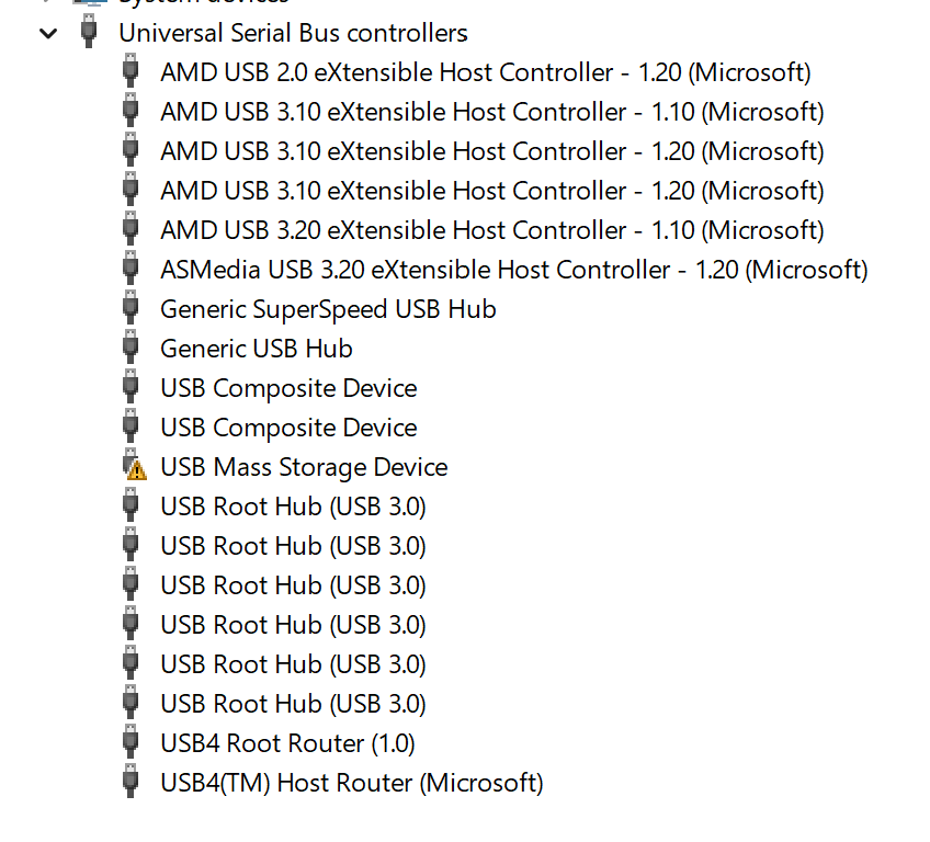

The Femto Bolt arrived today with firmware version 1.0.9. I followed the instructions using the Orbbec Viewer to upgrade to 1.1.2 but the device was never found again in “upgrade mode”. The front LED is solid orange and solid white on the back. It’s using the power and usb cable that came in the box.
When I try using the USBDownloadTool it fails to find the device. In the Device Manager it’s listed as a Mass Storage device, but with a yellow warning sign.
I’m struck.
Were you able to solve it?I’m feeling the same way.
Like I wrote: I power cycled the camera and the computer. So complete shut down and unplug. Then reconnect and power on again.
