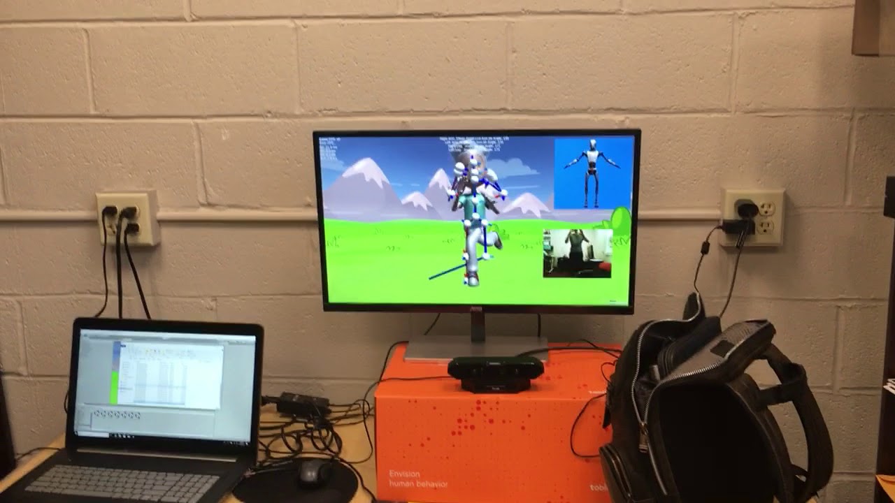

Hello wveryone, I have a problem using the unity SDK for Orbbec, when I run the scene, the avatar puts the legs in a wear position, I already run the application with the orbbec device in many locations and different lighting conditions, I also made tests with the unity Chan avatar from unity asset store and I had the same results.
I hope someone could help me solve this problem.
